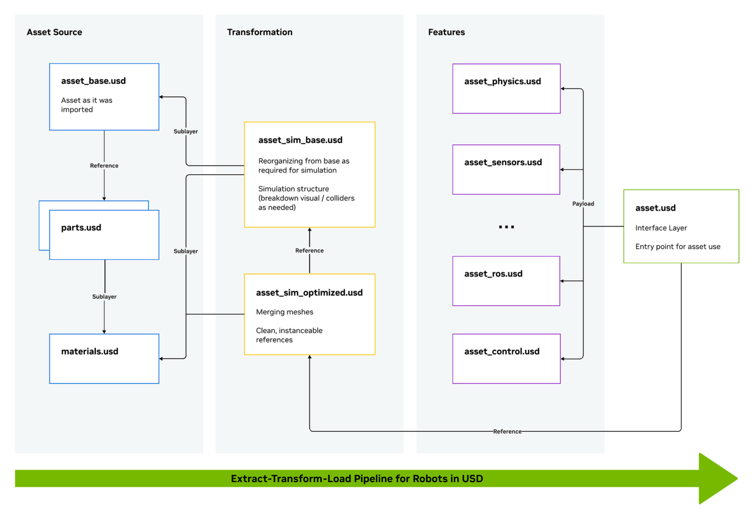

1.2.1 Schema Isolation and Functional Layering (The ETL Pipeline)
Extract-Transform-Load Pipeline for Robots in USD Figure 1: The Extract-Transform-Load (ETL) composition pipeline for OpenUSD robotics assets. Source: NVIDIA Developer Blog
As illustrated in Figure 1, assets should be divided into functional layers composed via References and Payloads:
  • Layer Separation: Assets must use functional layering (ETL) to isolate core OpenUSD data from simulation and ROS-specific schemas. This prevents “Unknown Schema” errors in standard tools and enables modular updates.
  • Layer Encoding: Schema- and relationship-bearing layers must be authored as ASCII (.usda); heavy-data layers as binary Crate (.usdc).
  • The Base Layer: The core data must be decomposed into granular, functional files to maximize deduplication and performance:
    • geometries.usdc: Contains pure mesh topology and vertices (no physics, no schemas).
    • materials.usda: Contains material and look-dev definitions.
    • instances.usda: (Optional, recommended): Assembles geometries and materials via references.
    • base.usda: The pure kinematic hierarchy (Xforms), referencing the underlying instances and geometries without physical or execution logic.
  • Features (The Domain-Specific Layers): Domain metadata must be isolated into overlay files, including:
    • physics.usda: Contains UsdPhysics rigid bodies and joints.
    • ros.usda: Contains the Ros*API schemas.
  • Entry Point ([asset_name].usda): The final distributed asset must be a lightweight interface layer that uses Payloads to load the Features.
  • Proprietary Layer: Simulator-specific implementations (e.g., proprietary execution graphs) must be limited to what is strictly necessary and confined to a separate proprietary layer (e.g., isaac.usda, o3de.usda).
1.2.2 The Composition Model
