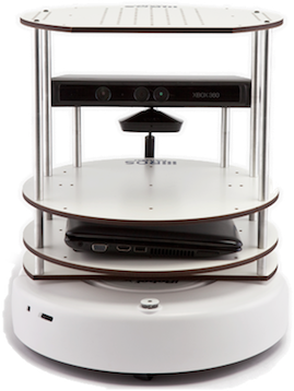

A TurtleBot{alt=”An image of a TurtleBot” width=”260px”}
The TurtleBot is trademarked by Willow Garage. If you would like information on producing TurtleBot branded product please contact Willow Garage at turtlebotinfo@willowgarage.com . This document is designed to allow others to develop robots which can take advantage of the growing community around the TurtleBot design.

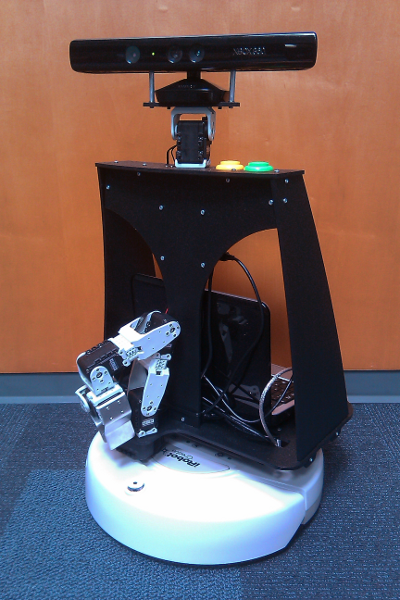

There are many tools and applications written for the TurtleBot which can be useful for other similar robots. Level 2 compatible robots are a subset of these robots for which a majority of the applications will work. There are already a number of robots which are TurtleBot compatible such as Mini Max3 and Pi Robot4 .
Mini Max the robot.{alt=”An image of Mini Max” width=”260px”}

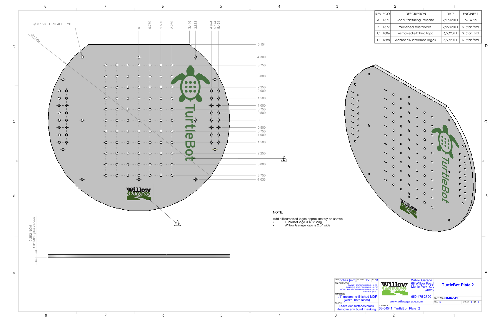

  • The top mounting surface of the robot must provide a hole grid pattern centered around the z-axis of the robot base_link that is identical to the 68-04541_TurtleBot_Plate_2 part found in the TurtleBot hardware documentation and shown in the figure below.

TurtleBot Mounting Surface.{alt=”An image of the top mounting surface” width=”100.0%”}

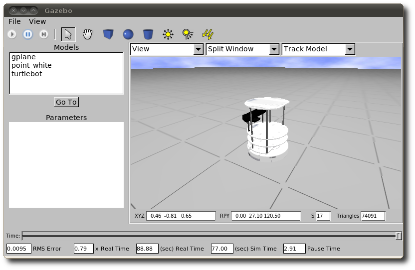

There is a package which provides the necessary Gazebo model for Level 1 compliant robots. See the turtlebot_simulator stack 7 for more information.
It is recommended for Level 2 compliant robots to release a stack with the gazebo model(s) which allows them to be simulated as well, to ease development for developers who do not always have access to hardware.
The TurtleBot simulated in Gazebo{alt=”A screenshot of the TurtleBot in the Gazebo Simulator”}
